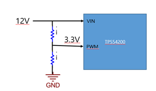

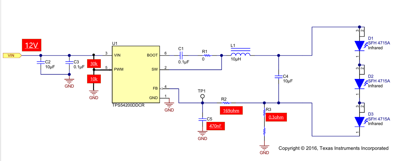

I've tested like below circuits, vin and pwm voltage applying at the same time.
the result is output irled is not turned on. irled is connected serial 4 ea. but it is turned on in case reducing irled 4ea to 2ea.
could you explained why it is ?
