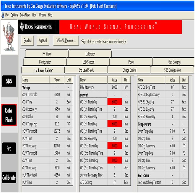

Hi Jason,
Below you can see snapshot of my Data flash
But as soon as I changed AFE OC DSG from 0x12 to 0x17, some of values get automatically changed.
Rsns= 10mohm.
It happens in some of the boards, while others are fine.
I don't know why it happens. Kindly help.
Deepak,
All of those changed parameters correspond to the default settings. It might be possible that the displayed values are the defaults but the values in the gauge haven't actually changed. Try reading all dataflash values again and see if they are still changed from what you had them.
Jason
