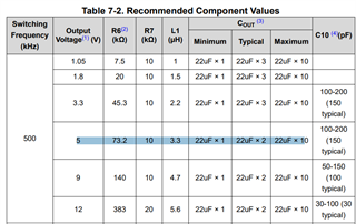

Suggest a Buck regulator to Power on the RF circuitry. Vin is 12v, Vout is 6V current is 8A. This buck regulator will be used to power on Other LDOs
Hi Vaishak\
I assume you are not to using the PGOOD function, right? Then the circuit is ok.
If the PG function is to be used, it should be connected to a voltage rail <5.5V, through a pull up resistor, If the PG function is not used, it's ok to connect it to Ground or floating.
Thanks and best regards.
