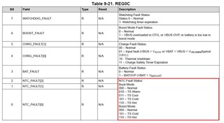

I have a question about BQ25890 fault register (REG0C).
1. I want to know the temperature definition and temperature range of each item (total 8 items below) in case of NTC Fault Status.
I couldn't find those information in the datasheet.
(1) Buck Mode
 - Normal :
 - TS Warm :
 - TS Cool :
 - TS Cold :
 - TS Hot :
(2) Boost Mode
 - Normal :
 - TS Cold :
 - TS Hot :
For example, when temperature goes down, TS Cool starts at X degC and if it exceeds XX degC, it turnes to TS Cold.
I would like to know what temperature each item is defined as.
ex) Normal : 10~45 degree
TS Warm :  45 degree
TS Cool : 10 degree
TS Cold : 0 degree
TS Hot : 60 degree
2. I would also like to know whether the temperature for each item is fixed or adjustable.
Thank you
Hyunkug

    The temperature thresholds are not fixed. They are determined by the NTC used, as well as, the resistor divider network at TS. The necessary circuit to connect at TS pin is shown in Figure 9-6 on BQ25890 datasheet page 27.
    TS Warm :  45 degree
    TS Cool : 10 degree
    TS Cold : 0 degree
    TS Hot : 60 degree
    These values are the expected temperature thresholds using the recommended 103-AT NTC and RT1 = 5.24kohms and RT2 = 30.31kohms. These thresholds are also shown in datasheet Figure 9-7.
    Please be aware we also provide an Excel based tool (bq2589x Calculation tools) to help with resistor selection given desired temperature range. It can be downloaded on the BQ25890 product page on TI.com under the 'Design & Development' section. https://www.ti.com/product/BQ25890
    Boost mode hot and cold thresholds are set by the same NTC and resistor network, but can be modified further via register settings (REG01). Further details on boost mode temperature range can be found in datasheet section 9.2.7.5.2.

    1. How MCU can check the temperature from charger IC? MCU reads the specific register (ex TS pin related) and check voltage level of TS pin and then convert it to temperature? or any other way?
    Correct, MCU code will need to convert the TS pin percentage output in REG10 to temperature value given expected resistance of NTC at a certain temperature. Additionally, REG0C bits 2:0 can be monitored to know whether the device is in normal temperature operation range compared to TS WARM, TS COOL, etc.

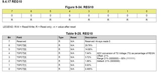

  • Hi Garrett,
    Thank you very much. Your answer was very helpful.
    But I did not understand fully about temperature reading from REG10.
    Could you elaborate a little more on the relationship between ADC conversion of TS Voltage as percentage of REGN and temperature?
    What's the meaning of each percentage? Is there a fomular?
    I want to know this REG10 table.
    Thank you!
  • Hi Hyunkug,
    The conversion of TS voltage as a percentage of REGN to temperature depends on the specific NTC you are using in your system. The TS voltage is controlled by the resistor divider network so voltage % only changes as NTC resistance value changes.
    In general higher TS voltage % indicates lower temperature and lower TS voltage % indicates higher temperature. To convert from TS voltage % to temperature you will need to use the voltage divider equation to determine the corresponding NTC resistance value for a specific TS voltage % reported in REG10 then map that resistance to its corresponding temperature.
    Garrett
