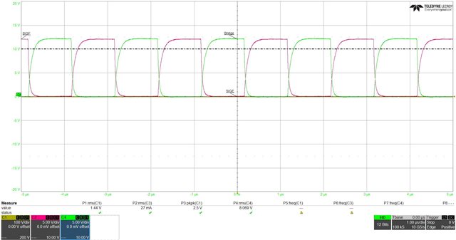

  • Hi Jememiah.
    I attached what you wanted waveform.
    1)  FET  gate input signal. (Pushpull A, B)
    FET Gate pin (Push-Pull)
    2)  Signal in, Enable, VDD.
     - C1 : Signal input.
     - C3: VDD (12V)
     - C4 : Signal output.
    Signal in, VDD, Signal out
    3)  Signal Input, Enable, Signal Output
    Signal input, Enable, Signal output.

  • HI Sanghyun,
    The waveforms you most recently sent look like typical behavior we'd expect from the device. Is this setup that you took the waveforms on performing without failures?
    Something else of note though is there is a lot of noise on the VDD signal on switch. One other recommendation is rotating the C12 and C33 capacitors 90 degrees so they are perpendicular to the device pads, making sure the 0.1uF capacitor (C12) closer to the device.
    Jeremiah
