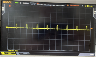

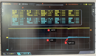

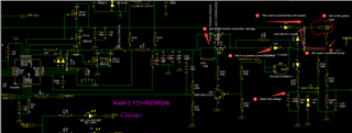

BQ24650 sets the charging current to 4A, MTTP voltage to 18V, and float charging voltage to 14.5V. After charging for a period of time, the STAT1 indicator light flashes once every second. The specification sheet does not specify the flashing status. At this time, the voltage of the lead-acid battery jumps from 13.3V to 14.2V, with a charging voltage of 24V and no charging current. Excuse me, what does the flashing indicator light of STAT1 indicate?
