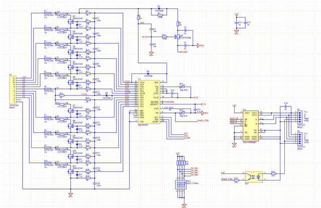

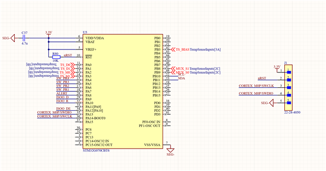

Hi, I'm trying to build a BMS with this chipset but I can't manage to read the registers.
This is the schematic:
Hello Andrea,
I would recommend to read Section 6 Communications of the bq76920, bq76930, bq76940 AFE FAQ document and check all of these conditions. There are some suggestions here that may help in checking what may be wrong.
