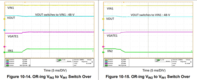

  • Hi Shiven,
    Thanks for your reply
    We are using external MOSFET, infineon IPB017N10N5LF.
    PS1=52V, PS2=48V
    What we saw is shown below
    Is drop voltage caused by gate charge time delay?
    Jack Sato
  • Hi Jack,
    Yes, drop voltage is because of gate charge time.
