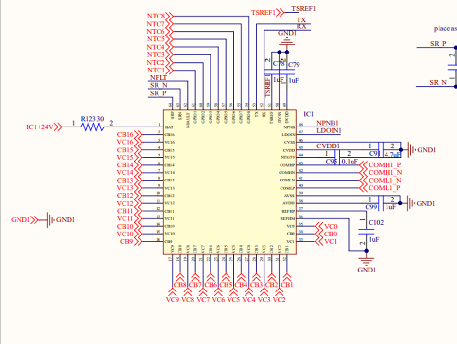

  • Hi Sudhir,
    Can a schematic please be provided for the cell connections?
    David

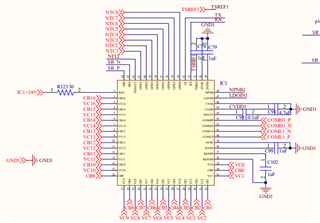

  • Hi David
    Thanks for reply
    below is my schematic part
      Thanks.
  • Hi Sudhir,
    The circuit seems correct. With a Multimeter, what is the voltage measured across VC16 to VC15?
    David

    Can you verify my input circuit for BAT
    ( i am using external power supply for BAT)
    Below is my circuit
  • Hi Sudhir,
    I would refer you to the following section on powering the IC with an external power supply:
    If all cells are 3V, VC16 would be 48V. To read cell 16 properly, the bat pin would need to be more than 48V*0.5 + 2V. Therefore, BAT would need to be supplied by 26V or more.
    David
  • Hi David,
    Thanks for reply
    I am connecting 16 cells to BQ79656-Q1  and as per the data sheet the minimum input voltage will be (16*3.2V*0.5 + 2V=27.6V)  right now i am giving 29V to BAT but getting issue on Cell 14 cell 15 and cell16 .

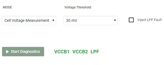

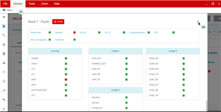

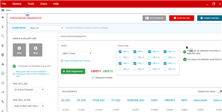

  • Hi Sudhir,
    Does the BQ79616 report any faults in the fault registers? The goal would be to find any errors in FAULT_SYS or FAULT_PWR1, 2, 3

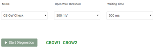

    A second test is to run the diagnostics. These would be to check if there are any wiring faults. There would be three diagnostics to run in the "Diagnostics" tab:
    1. Cell voltage measurement check. Set Voltage threshold to 30mV and see if any errors occur in the VCCB1 or VCCB2 register. If there are VCCB fails then this can be looked at in more detail in the fault registers tab.
    2. CB OW check. Run with the below settings. any faults can be looked at in the fault registers tab.
    3. CBFET check. Run with odd cells and then switch to running with even cells.
    To eliminate the external power supply as the issue, could you disconnect the external power supply and connect cell 16 to the line that provides power to the BAT resistor and Rnpn resistor? This way cell 16 is powering the BQ79616. If the issue is still observed, then the issue would not be the external power supply.
    David

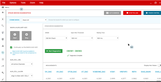

  • Hi David,
    Thanks for reply
    Below are the results
    (1) Cell voltage measurement check.
    (2)CB OW check.
    (3) CBFET check
    Fault

  • Hi David,
    I connect cell 16 to the line that provides power to the BAT resistor and Rnpn resistor
    This time I am getting issue on cell 15 reading    (cell 15 reading is -3.2V ,through multimeter voltage is 2.4V)
    Cell 16 is giving correct reading.
  • Hi Sudhir,
    Cell voltage measurement and CB OW is failing in the top cells (9-16). This typically indicates a wiring problem. After performing the cell voltage measurement check, please check the FAULT_COMP_VCCB1 register. This will display which cell is having the issue.
    Once the problematic cell has been determined, Measure the CB pin voltage and the VC pin voltage to determine what pin is not receiving the expected voltage. If the voltage appears as expected, measure cell n+1 and cell n-1 to determine if there is an issue with the connection above or below that cell.
    David Ray
