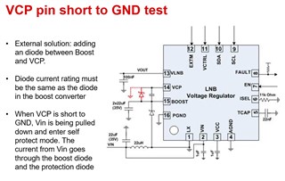

Hi
Previously, shorting the VCP and GND of TPS65233 caused the ic to burnt.
At that time, TI guided the addition of diode to VCP as attached file.
I'm going to use TPS65235 this time.
Do I need to add a diode to prevent bunting for this as well?
