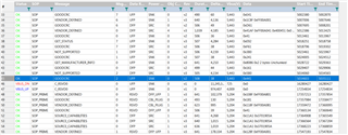

  • Hi Raymond, Does .ccgx format work for you?
    https://e2e.ti.com/cfs-file/__key/communityserver-discussions-components-files/196/Auto-nego-sink-4.5W-_5F00_iPhone-15-pro.ccgx3
    It looks like the iPhone's capability is 5V/900mA.
    Disconnecting the J2 adapter starts from line #45 as below.
    Thanks!
    Jay
