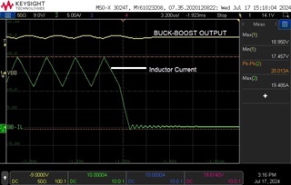

Please clarify, We have an issue with the Hiccup current limit feature.
Vin Min: 10V
Vin Nom: 12V
Vin Max, 24V
Vout - 18V
Output Current Max: 10A
Fsw – 250KHz
Inductance: 2.2 uH
I have enabled the hiccup by connecting the Mode Pin to GND via a 93.1k resistor.

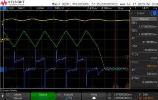

No issues on 24V operation, but when the converter is in boost mode (12V operation) and if I increase the load between 6 - 7A, at this point the converter enters into hiccup mode current limit.
I have not used the average current limit option; rather, I have used a 5-mohm current sense resistor on low-side MOSFETs and connected to the CS-CSG Pins.
As per calculation, the peak inductor current threshold at boost mode is set for 24 A. The inductor saturation current is 62 A.
Can I change the sense resistance from 5 mohm to 4 mOhm? So that the peak current limit threshold will be 30A. Also, do I need to alter the slope capacitance value? Currently it is 180 pF.

  • Hi Naveen,
    as you can see from the scope plots your current in the inductor and the corresponding voltage on the Current Sense resistor at CS/CSG is reaching the current limit level. Therefore the HICCUP mode can be triggered.
    You need to decrease value of  the current sense resistor - so the 4mOhm could be a good option.
    Yes, slope compensation should be readjusted.  Please use the formula given at:
    8.2.2.8 Slope Compensation
     Stefan
