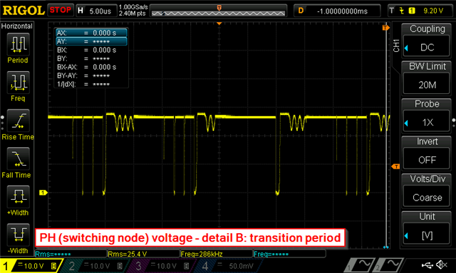

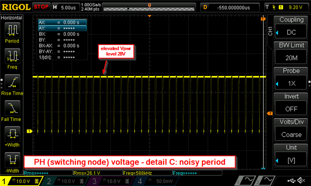

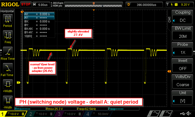

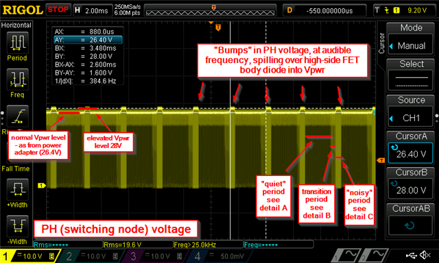

Quick reminder: during end stage of charging ("Fastcharge voltage regulation phase"), when current is ramped down, the output voltage (called "Vpwr" on my desing, or "SYSTEM" in datasheet), experience little bumps from 26.4V to 28V. These bumps last about 0.5ms, and are repeated every 3-5ms. These cause audible effect on input ceramic capacitors (C8, C9 on datasheet fig. 20). What is significant, is that these bumps reach voltage that is higher than input power adapter, and obviously than battery voltage. It means this voltage must have been induced by switching action of charger. I can deal with the noise somehow, but again - is it something that can happen with BQ charger, or should I be worried that it is a symptom of underlying design error.
Let me show you screenshots of PH pin voltage (switching node):
Problem overview
detail A
detail B
detail C

I desoldered the diode between Vbat and Vpwr, but the noise is still there. Waveforms are exactly the same. This issue is encountered only during voltage regulation phase. During current regulation, everything seems fine, and PH waveform looks text-book correct.

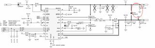

    Can you provide your updated schematic?
    The schematic I'm looking at does not show the caps.
    I also recommend reviewing the schematic checklist:BQ24610_BQ24650_Schematic_Checklist (58).pdf
    Christian.
  • Sure thing, here is updated schematics:
  • Hello Mateusz,
    I don't see any capacitance on VBAT.
    I have 6-in-series cells that I want to charge to 24.6V,
    VCharge is set to 24.44V, but you want to charge up to 24.66V?
    Is the inductor still 22uF?
    I recommend following the schematic checklist.
    Christian.
  • There is C1115 4u7 capacitance at the right side of schematic, just below schottky diode.
    Yes, I lowered VCharge to 24.44V because I want to charge to 24.44V. I have a feeling that BQ struggles because of something, I don't know what, and I want to make life easier for BQ to operate, eg. by giving it more voltage margin to operate within. And yes, this project is living. Since I am not happy with the results I get with this product, I constantly try to experiment and improve whatever I think needs improving. Because of that, in my posts, you may find that some parameters are not exactly the same as few posts before. So please excuse my inconsistency.

    After find my current loop probe, I checked battery current. In full current chaging, it looked nice, just steady level. But as long as Vbat approached Vrechg, it started to look messier and messier:
    And few moments later:
    I had no idea that this current looks so bad. I used TrueRMS meter before, and the RMS value was more or less correct.
    Clearly, there is negative battery current, therefore enegry flows from battery to charger. Datasheet even warns about it in p. 9.3.12 Cycle-by-Cycle Charge Undercurrent Protection:
    This is important to prevent negative inductor current from causing a boost effect in which the input voltage
    increases, as power is transferred from the battery to the input capacitors and leads to an overvoltage stress on
    the VCC node and potentially causes damage to the system.
    Out of curiosity, when hearing noise, I started to manipulate input adapter voltage. When slightly increased, noise seemed to shift up in frequency and be less annoying. In my product I cannot increase input voltage, but I can lower Vreg. I set it to 23,5V. So now, BQ has a margin of 26,5Vadapter - 0,3Vshottky - 23,5Vreg = 2,7V to work with. Now there is practically no noise, and charge termination is accurate and repeatable. And battery current waveform look fine throughout whole charging process. Only downside - I sacrifice a fraction of battery capacity, since I will never charge it to full possible voltage. Anyway, I think datasheet should be more specific about relationship between Vcc and Vreg.
