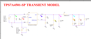

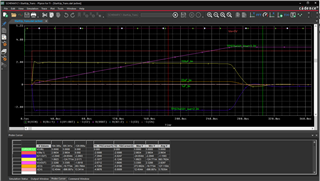

The TPS7A4501-SP (Flight Prt Num: 5962R1222403VXC) does not have a soft start feature, consequently when enabled with stable Vin, Iout appears to go to the maximum current limit (~2.3A simulated, which is in excess of the recommended 1.5A max operating current) and stay there until the load capacitance is fully charged, at a rate and duration determined by:
Ic=C[dV/dT], see simulation waveforms attached.
For this application Vin=5V, Vout=3.3V, Cout=(150uF + 22uF + 1uF), see schematic attached.

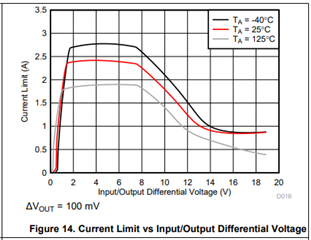

    The behavior you describe is essentially correct (see the waveform from the EVM User Guide below) and the ~2.3A limit is in line with the datasheet graph.
    Since the spec we guarantee the reliability and performance of the device against is the maximum rated output current (1.5A), we can't make any conclusive statements about the expected impact of indefinite operation at current limit. The device does have some degree of safe operating space protection built in relating power dissipation and device temperature, but this protection feature is not meant to be used as the indefinite nominal operating condition.
    I would not be overly concerned about this specific case of VOUT startup/recovery as it is temporary and relatively brief in nature with respect to long-term mission profile. With that said, maximum current limit time (with degradation to reliability/performance over time) is not something that has been defined or specified. Do you anticipate that it will occur frequently or over long durations in your design?
