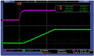

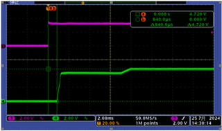

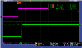

My customer has been evaluating TPSM83100 by TPSM83100EVM, and found out soft-start ramp time is not in the typical value in some cases.
1. When the output load is 0 ohm which means no load, Td(RAMP)=0.16ms.
2. When the output load is electric load and output current is 0.49A, Td(RAMP)=7.15ms.
3. When the output load is 10 ohm, Td(RAMP)=0.4ms.
I also found that IL(lim_SS) decides soft-start ramp time is fast or not. May I know the value of IL(lim_SS)? My customer cannot define the soft-start ramp time in customer's use case based on the datasheet.
