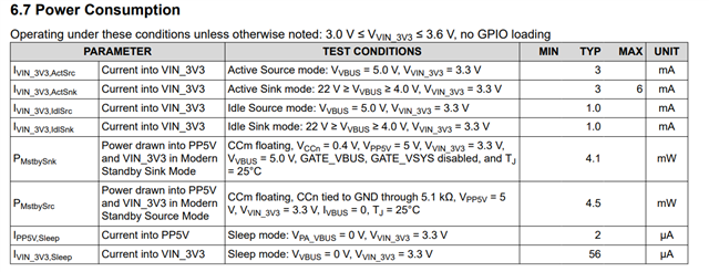

May I know the TPS25751D standby current in DRP role? The standyby power consumption can I reference to Ipp5V,sleep(2uA) + Ivin_3V3,Sleep(56uA) = 5*2 + 3.3*56 = 10 + 184.8 = 194.8uW?
Since our device have integrate battery, we concern about the standby power to make sure TPS25751 won't take more power consumption in standby more. Thanks!

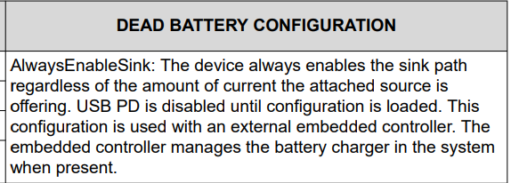

    question 3, if we choose dead battery configuration = AlwaysEnableSink, does there have any reference design can share to us?
    We do not have any reference design with AlwaysEnableSink enabled, however you can use TPS25751EVM and configure the S1 and S2 switch to be in this DB mode:
    The TPS25751EVM user guide includes specific instructions on how to connect TPS25751EVM with BQ25792EVM for evaluation purposes. Additionally on TPS25751EVM if you remove J16 jumper this will simulate a non-EEPROM PD system (EEPROM is disconnected from PD) and you can use a host MCU launchpad to communicate with the EVMs.
    Regarding your original query on power consumption, this is correct calculation.
