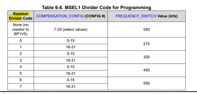

Could you please help to clarify what's the "Resistor Divider Code" and how to configure the frequency? Thanks.

Hi Rannie
1. you can use the Power fusion Gui in off-line mode to select the pin strap in pin strap tab
2. you can also use the excel calculator for designing which i am attaching here and also use the pin strap tab to select thr pin strap table
a.In device calculator tab input cell E127 (CZI value) and cell E129 (CPI value) manually from cells F97 (CZI calculated value) and F98 (CPI calculated value) to update the frequency curves
3. or you can select and calculate the pin strap as mentioned in the data sheet
for frequency
first select the Resistor Divider code for required Freq
after selecting the resistor divider code see if selected resistor divider is no divide, even divider or divider based on that choose the Resistor to Ground code
once you have both the codes for resistor divider and resistor to ground use the look up table on the datasheet for resistor values
