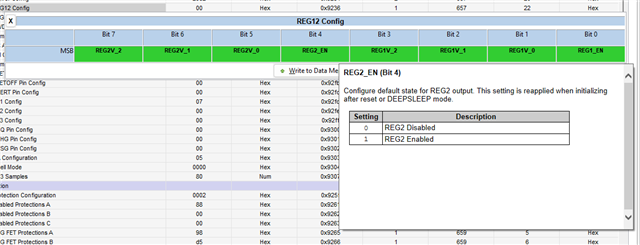

  • Hi Zhang,
    1. No, sorry I meant the PMOSFET that you added. Just make sure that you disable REG2 to disconnect the LD pin from PACK+.
    2. You can disable them using the REG12 Config Register:
    3. Yes this seems feasible.
