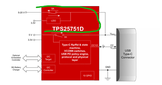

     i am a little confused about the usage of PP5V function.
     Question1: the PP5V path support 3A current. does it intend to supply the VBUS device?

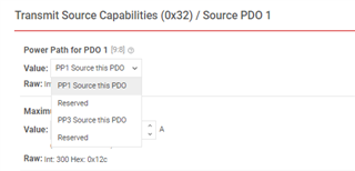

     Question2: if TPS25751D is config as a source, like 5V/1.5A output. the power path is from PPHV to VBUS or from PP5V to VBUS?
     Question3:do have chance if  PP5V to VBUS and PPHV to VBUS  opens simultaneously?
thanks a lot.
    Yes, PP5V can supply VBUS at 5-V when sourcing. It can support up to 3-A. It is only for 5-V sourcing, higher voltage sourcing would go through PPHV.
    5-V can be sourced from both PP5V and PPHV. Only one is used at runtime, and the setting for which power path is used for 5-V is configurable in the GUI.
    PP1 corresponds to PP5V, PP3 corresponds to PPHV.
    By default, both power paths will be open (non-conducting).
    If you are using PP5V for 5-V, and PPHV for higher voltages (i.e. 9-20-V), there may be a short period of time where both are closed and conducting when transferring between votlage levels.
    Thanks and Regards,
    Chris
  • hi,
       if  there is a short period of time where both are conducting. do the PPHV  current  will flow to the PP5V and make the system confusion?
    The PD controller will be fine, and it should be short enough that the system will stay stable.
