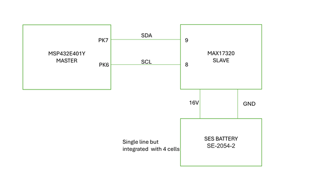

    I have a question regarding the BQ34110EVM-796 Evaluation Module (Rev. A) fuel gauge EVM. We are planning to interface the BQ34110EVM with an MSP432E401Y microcontroller using the i2c_mastermode_simple_transfer example. Our plan is as follows:
    1. First, we plan to test the BQ34110EVM with the MSP432E401Y microcontroller on our custom board using I2C.
    2. Once this is successful, Our main Aim to test the onboard BQ34110 fuel gauge on our custom board (MSP432E401Y with BQ34110 sensor)-I2C interface.
    I would like to know if using the i2c_mastermode_simple_transfer example will allow us to read all the parameters of the BQ34110 fuel gauge without needing the BQ34110 bare-metal driver.
    The reason for my question is that we previously used the MAX17320G fuel gauge IC connected with an SE-2054-2 (SE20542NR29) 4-cell battery (16V output on pin 1), and we connected it to the BATTS pin. However, we were unable to read the battery parameters of the MAX17320G fuel gauge.
    In our new setup, as described above, we plan to replace the MAX17320G with the BQ34110 on our custom board. Could you please let us know if any additional configuration is required to read the fuel gauge parameters, or if we can directly use the i2c_mastermode_simple_transfer example for this purpose?

      I don't have experience with BQ34110 but reading its datasheet, the I2C interface commands are fairly straight forward. It's just 1 byte write, 1 byte read or incremented read operation. The examples I provided earlier and the app note can serve as a guide for you to adapt to BA34110.
