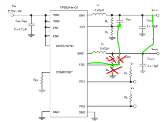

as I'm planning to use TPS62442 as a dual output step-down converter, I was thinking of using the same regulator in the same project in a dual phase configuration to provide more output current (4A) by "shorting" both output channels as in the attached picture and using only one resistor divider to connect to both feedback pins (green: new connections, red: removed).
Is there anything I should be aware of when using the regulator in a dual phase configuration, or would you not recommend using the regulator in this mode?

    thanks for using E2E.
    The configuration, you have in mind has not been tested. I quickly simulated this configuration with the help of the available PSpice transient model and it worked but Vout did not look stable.
    I would not recommend this configuration because there are several single phase 4A devices available (such as the TPS62810) which operate in a tested configuration and you would also save solution size and BOM cost.
    Andreas.

    Of course there are other small devices, which are capable of higher currents, but the idea was, that if I'm using this regulator on the same board, I might be able to reuse it.
    Also Vout looks instable in the simulation, maybe I'll get an eval board and test it. If the transfer function is stable, there is no need to worry.
