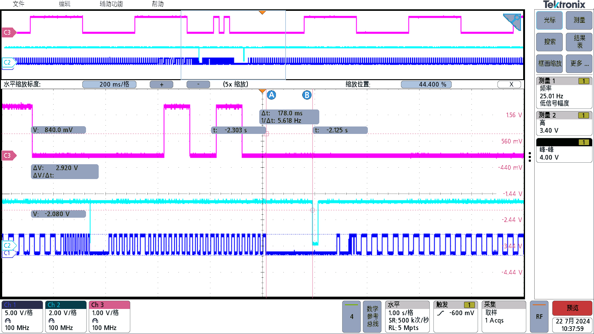

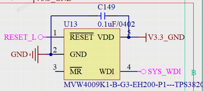

My customer reported an urgent issue that they found TPS3820-Q1's ttout (Watchdog time out) changed permanently after they implemented the high temperature test (100 degree).
In the below waveform, reset was triggered after WDI keeping low for 178ms. We told customer that the timing was still within our datasheet spec, but before the high temp test, no reset event occurred with the same WDI timing. The phenomenon occurred at every parts they tested.
Could you please help explain the possible reasons?
CH1:WDI  CH2: /Reset
