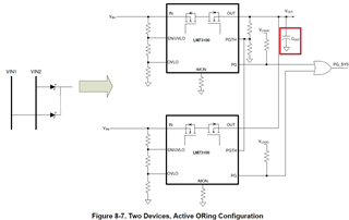

LM7310: About output capacitor
Part Number: LM7310
Dear Experts, please refer to below figure. I use two lm7310s to achieve two power source input function. Two power source may exist at the same time or only one power source exists. Due to limited PCB size, 470uF Electrolytic Capacitor is too big. Is 470uF Electrolytic Capacitor necessary for lm7310? I can change to 20uF MLCC? The Load current is about 3A.  Best regards.
