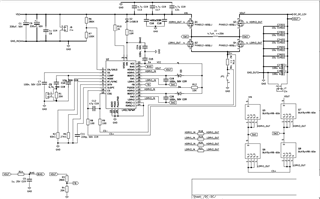

I am designing DC-DC buck-boost converter using LM5176.
Specification:
Input: 9V to 36V
Output: 12V/6A
Switching frequency: 280 kHz

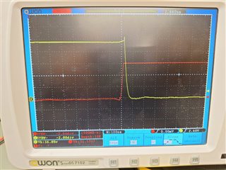

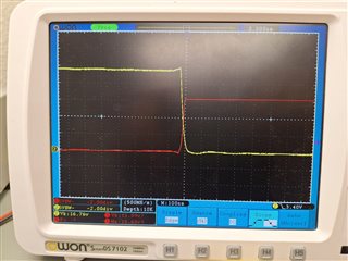

Yellow - High side switch
Red - Low side switch (Inverted)
As seen in picture I am getting almost no deadtime between high side and low side switch operation.
Question 1: How I can add deadtime?

    1. as you can see there is a dead time of some 10ns which is what should be there. So for me this looks OK.

    1. I think as shown in picture there are pulses overlapping for minimum 20ns, means no deadtime. By the way I increased the gate resistor with antiparallel diode that helps me little bit.

    I think I have to check replacing 1 by 1 components and have to check. Can you give your guess for which component probability of damaged is highest?
    I also prepared to other boards and both of them worked as expected. Just because of thermal management issue I couldn't put for long run taste as temperature reaches just above 70 degree Celsius.
    With a horizontal scale of 100ns/div this dead time is hard to see.
    I missed that you have placed gate resistors as this are moved to the lower right boarder. Can you let me know which values you are using here?
    If gate resistors are used the internal circuit to ensure dead time is not violated can be interfeared. So if gate resistors are used this should be less then 5Ohm but also depends an the Gate charge.
