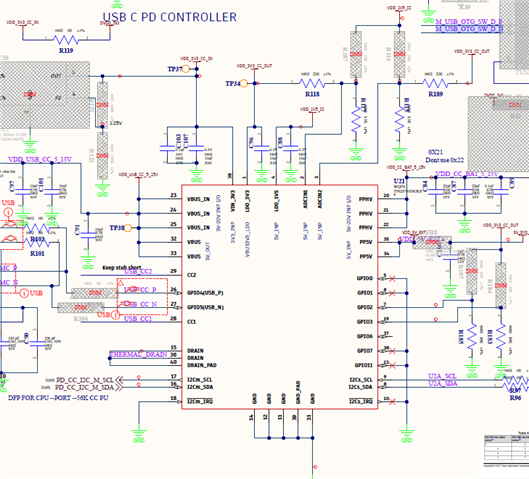

  • How to negotiate for higher voltage in dead battery configuration ?
ADC1 AND ADC2 value set are 33 and index --2 which is negotiate high-voltage but with dead bat its negotiation for 5v after dead bat when battery is charged and if VDD_3V3_CC_IN is available if usb is unplugged and plugged back its negotiating for 15v how to solve this by clearing any register during host boot or any other thing is missed out we need to achieve it by doing without removal and plug back of usb?
