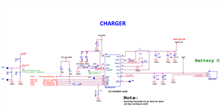

We are using BQ25622 for Battery charging application in our system. It receives input voltage VBUS (5V0_MAIN) from 5v Buck converter. Our system (AM62, Wi-Fi, GSM, GPS etc.) is powered by "VMAIN_SYS". We have requirement where in our system should work with or without battery so by default battery charger will be in a charger enable mode. Can you Suggest How to get a stable power at "VMAIN_SYS" if battery is not inserted. Since we are facing system reboot issue when Wi-Fi image being loaded, sim card insertion (when battery is not present in the system).
CE, I2C, INT, STAT pins are connected to AM62 processor

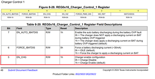

    Whenever the battery is not connected please disable charge in the registers.
    Mike Emanuel
  • Hi Michael, Are you referring to the Register (EN_CHG). If yes, then please let us know apart from "EN_CHG" which registers need to be disabled for stable power without battery
    Yes, set Charge Disable by setting CHG_EN = 0.

    Here i want to bring 2 scenarios .
    case 1 : when only external power supply connected , GSM & wifi modules creates rebooting the system .
    case 2 : when only battery connected , then GSM & Wifi  working fine (not rebooting the system)
    case 3 : when battery and external supply connected also system is not rebooting

    May i know which register should i check ? please suggest .
    Below Register i checked when both battery and external power supply connected.
    register 16 - 0xa0
    Register 17 - 0x4f
    Register 18 - 0x4
    Register 19 - 0xc4
    Register 1e - 0x0c
    Naresh

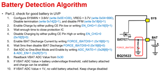

    Garrett, it would be a great help if you can provide us an algorithm example of how to perform the battery detection using our host MCU & BQ25622 registers and based on the battery detection we also need to set the CE pin high/low (i,e.: Charging Functionality Enabled/Disabled).

  • Hi Amarnath,
    Thanks for the reply. Please see my comments below.
    Below images are the battery detection algorithm example you can implement with your host MCU and BQ25622. A couple things I would like to point out.
    • You are free to pull /CE pin high/low or write 'EN_CHG' bit via I2C to disable/enable charge. You do not need to perform both actions, so you can choose what is more convenient for your system.
    • The register configurations in part 2 step 1 are intended to mitigate the SYS output instability when charge is enabled and no battery is present. After battery detection algorithm is complete the various settings modified in step 1 should be set back to the desired values for normal operation.
    Please let me know if you have any follow-up questions on the battery detection algorithm example.

  • Hi Garrett,
    Thanks for information.
    We implemented the Battery algorithm part1 where we noted "Vbat_adc values from register 0x30 "  in below mentioned cases .
    we tested the below cases with battery (3.7volts ,1000mA)  and external power supply (12v).
    case 1 : with only External Power supply :
    we took the vbat_Adc readings and other registers values continously we observed that vbat adc values changes on reboot and the value is constant if read again.  Please find the atatched log where we took vbat_Adc readings.
    with power supply

    [    4.219916] monika: part1 : before clearing 5th bit of EN_CHG register value: 0xa0
    [    4.229364] monika: part1 : After clearing 5th bit EN_CHG register value: 0x80
    [    4.237320] monika: part1 : reading BQ2562X_FORCE_IBATDIS_REG register value: 0x80
    [    4.246392] monika: part1 : setting 6th bit of BQ2562X_FORCE_IBATDIS_REG register value: 0x88
    [    4.262256] monika: part1 :after clearing 6th bit of BQ2562X_FORCE_IBATDIS_REG value: 0x88
    [    4.271255] monika: part1 : before enabling 6th and 7th bit of BQ2562X_ADC_REG register value: 0xb0
    [    4.281815] monika: part1 : after setting 6th and 7th bit of BQ2562X_ADC_REG register value: 0xf0
    [    4.295937] monika: vbat_adc_value value: 63520
    root@am62xx-evm:~# dmesg | grep monika

    [    4.245648] monika: part1 : After clearing 5th bit EN_CHG register value: 0x80
    [    4.253592] monika: part1 : reading BQ2562X_FORCE_IBATDIS_REG register value: 0x80
    [    4.262661] monika: part1 : setting 6th bit of BQ2562X_FORCE_IBATDIS_REG register value: 0x88
    [    4.279071] monika: part1 :after clearing 6th bit of BQ2562X_FORCE_IBATDIS_REG value: 0x88
    [    4.288129] monika: part1 : before enabling 6th and 7th bit of BQ2562X_ADC_REG register value: 0xb0
    [    4.298677] monika: part1 : after setting 6th and 7th bit of BQ2562X_ADC_REG register value: 0xf0
    [    4.309192] monika: vbat_adc_value value: 50000
    root@am62xx-evm:~#
    root@am62xx-evm:~#
    [    4.236542] monika: part1 : before clearing 5th bit of EN_CHG register value: 0xa0

    case 2 : with battery + with external power supply
    we took "Vbat_Adc " readings continously ,but we observed that this value is constant even if we rebooted. Please find the atatched log where we took vbat_Adc readings
    with battery + power supply

    Please find the Battery algorithm part1 code
    static int bq2562x_detect_work(struct bq2562x_device *bq) {
            int ret;
            //static int count = 0;
            int vbat_a_lsb, vbat_a_msb;
            u16 vbat_adc_value;
            int en_chg_value, ibat_dis_value;
            const u8 undervoltage_threshold = 0x20;
            const u8 no_battery_threshold = 0x10;
            int dis_term;
            //***** ALGORITHM PART 1 ********
            //step 1
            // 0x16 register 5th bit to clear
             en_chg_value = i2c_smbus_read_byte_data(bq->client, BQ2562X_EN_CHG_REG);
             en_chg_value |= (1 << 5);
             i2c_smbus_write_byte_data(bq->client, BQ2562X_EN_CHG_REG, en_chg_value);
            pr_info("monika: part1 : before clearing 5th bit of EN_CHG register value: 0x%02x\n", en_chg_value);
            en_chg_value &= ~(1 << 5);
            ret = i2c_smbus_write_byte_data(bq->client, BQ2562X_EN_CHG_REG, en_chg_value);
            pr_info("monika: part1 : After clearing 5th bit EN_CHG register value: 0x%02x\n", en_chg_value);
            //step 2
            //0x16 register 6th bit clear
            ibat_dis_value  = i2c_smbus_read_byte_data(bq->client, BQ2562X_FORCE_IBATDIS_REG);
            pr_info("monika: part1 : reading BQ2562X_FORCE_IBATDIS_REG register value: 0x%02x\n", ibat_dis_value);
            ret = i2c_smbus_write_byte_data(bq->client, BQ2562X_FORCE_IBATDIS_REG, ibat_dis_value | (6 << 0x1) );
            pr_info("monika: part1 : setting 6th bit of BQ2562X_FORCE_IBATDIS_REG register value: 0x%02x\n", ibat_dis_value);
            //step 3
            usleep_range(5000, 5100);
             //step 4
            // 0x16 register set
            ibat_dis_value &= ~(1 << 6);
            i2c_smbus_write_byte_data(bq->client, BQ2562X_FORCE_IBATDIS_REG, ibat_dis_value );
            pr_info("monika: part1 :after clearing 6th bit of BQ2562X_FORCE_IBATDIS_REG value: 0x%02x\n", ibat_dis_value);
            //step 5
            //0x26 register , enable 6th and 7th bit
            vbat_adc_value = i2c_smbus_read_byte_data(bq->client, BQ2562X_ADC_REG);
            pr_info("monika: part1 : before enabling 6th and 7th bit of BQ2562X_ADC_REG register value: 0x%02x\n", vbat_adc_value);
            // Set ADC to one-shot mode-> ADC_RATE and enable ADC_EN
            ret = i2c_smbus_write_byte_data(bq->client, BQ2562X_ADC_REG, vbat_adc_value | ((1 << 6) | (1 << 7))); // ADC_RATE=1, ADC_EN=1
            pr_info("monika: part1 : after setting 6th and 7th bit of BQ2562X_ADC_REG register value: 0x%02x\n", vbat_adc_value);
            //step 6
            //0x30 register
            vbat_a_lsb =  i2c_smbus_read_byte_data(bq->client, BQ2562X_ADC_VBAT_LSB );
            vbat_a_msb =  i2c_smbus_read_byte_data(bq->client, BQ2562X_ADC_VBAT_MSB );
            vbat_adc_value = ((vbat_a_msb << 8) | vbat_a_lsb) >> BQ2562X_ADC_VBAT_MOVE_STEP;
            vbat_adc_value = vbat_adc_value * BQ2562X_ADC_VBAT_STEP_uV;
            pr_info("monika: vbat_adc_value value: %ld\n", vbat_adc_value);
            //FIX it below code
            // Check if VBAT ADC value indicates a valid battery
    Kindly help me what is the battery undervoltage threshold value  and what might be the expected range of vbat_adc value ?
    Kindly provide your inputs /suggestions .
    Thanks ,
    Naresh
  • Hi Naresh,
    If you only have the battery connected it is expected that VBAT_ADC will be relatively constant. It will lower over time as battery discharges. For external power only case if charge is disabled then it is expected that VBAT_ADC will remain constant.
    Have you confirmed that the VBAT_ADC value read from REG0x30 matches expected battery voltage in your testing? Expected range is from fully discharge voltage for your specific battery to full charge voltage, which is typically 4.2V for Li-Ion battery.
    The battery undervoltage threshold will be unique to your battery/system, hence why it was not defined in the slide. The BQ25622 has a built in battery undervoltage protection with a falling threshold of 2.2V, but often customers have an external battery protector which disconnects battery from charger IC at a higher voltage.
    Garrett
  • Hi Garret,
    Thanks for your quick response.
    By taking Battery undervoltage threshold value as 2.2v , implemented both part1 and part2 algorithm recommanded by you . Kindly have a look
    This bq2562x_detect_work called in the end of the probe function

            // PART 1 - step 2
             * Enable IBAT Discharge current
             * by writting FORCE_IBATDIS = 1 (write 0x16[6] = 1)
            //PART 1 - step 3
             * wait 5ms
            msleep(5);  // 5 milliseconds
            //PART 1 - step 4
             * Disable IBAT Discharge current
             * by writting FORCE_IBATDIS = 0 (write 0x16[6] = 0)
            //PART 1 - step 5
             * set adc to one-shot mode
             * and enable by writting ADC_RATE = 1 (write 0x26[6]=1) and ADC_EN = 1 (write 0x26[7] = 1)
            //PART1 - step 6
             * READBACK VBAT_ADC value from 0x30 register
             * if VBAT_ADC value  > battery undervoltage threshold , then valid battery attached and charge can be enabled
             * else continue PART2
            vbat_adc_value = vbat_adc_value & 0x0fff;
            pr_info("monika: battery undervoltage threshold value: %ld\n", undervoltage_threshold);
           if (vbat_adc_value > undervoltage_threshold) {
                    pr_info("monika: in if block :battery undervoltage threshold value: %ld\n", undervoltage_threshold);
                    pr_info("monika: Valid battery is attached. Charging can be enabled.\n");
                    // Here you can add logic to enable charging if needed
           else {
                    // ********* PART 2 *********
                    pr_info("monika: in else block :battery undervoltage threshold value: %ld\n", undervoltage_threshold);
                    //PART2 - STEP1
                     * configure SYSMIN = 3.84v (write 0x0e=c00),
                     * VREG = 3.7v (write 0x04 = B90)
                     * Disable termination (write 0x14[2] = 1 and
                     * Disable PFM (write 0x18[4] = 1)
                    //0x0e register 0x0c00
                    i2c_smbus_write_byte_data(bq->client, 0x0e, 0x00 );
                    i2c_smbus_write_byte_data(bq->client, 0x0f, 0x0c );
                    // 0X04 register 0x0B90
                    i2c_smbus_write_byte_data(bq->client, 0x04, 0x90 );
                    i2c_smbus_write_byte_data(bq->client, 0x05, 0x0b );
                    // Disable termination (write 0x14[2] = 1
                    dis_term = i2c_smbus_read_byte_data(bq->client, 0x14);
                    i2c_smbus_write_byte_data(bq->client, 0x14, dis_term | 0x04 ); //set 2nd bit of 0x14 register
                    //Disable PFM
                    dis_pfm = i2c_smbus_read_byte_data(bq->client, 0x18);
                    i2c_smbus_write_byte_data(bq->client, 0x14, dis_pfm | 0x10 ); //set 4th bit of 0x18 register
                    //PART2 - STEP2
                     * Enabling charge CE pin by writing EN_CHG = 1 (write 0x16[5] = 1)
                     // setting 0x16 register 5th bit
                    pr_info("monika: part2 : before EN_CHG register value: 0x%02x\n", en_chg_value);
                    //PART2 - STEP3
                     * wait to close the protection ic
                    msleep(100);  // 100 milliseconds
                    //PART2 - STEP4
                     * Disabling charging
                     * writing EN_CHG = 0 (write 0x16[5] = 0)
                    pr_info("monika: part2 : After clearing 5th bit EN_CHG register value: 0x%02x\n", en_chg_value);
                    //PART2 - STEP5
                     * Enable IBAT discharge current
                     * by writting FORCE_IBATDIS = 1 (write 0x16[6] =1 )
                    //setting 0x16 register 6th bit
                    pr_info("monika: part2 : reading BQ2562X_FORCE_IBATDIS_REG register value: 0x%02x\n", ibat_dis_value);
                    pr_info("monika: part2 : after setting 6th: BQ2562X_FORCE_IBATDIS_REG register value: 0x%02x\n", ibat_dis_value);
                    //PART2 - STEP6
                     * wait 5ms
                     * then Disable IBAT Discharge current
                     * by writting FORCE_IBATDIS = 0 (write 0x16[6] =0 )
                    // Disable IBAT Discharge current (write 0x16[6] =0 )
                    pr_info("monika: part2 : after clearing 6th bit of BQ2562X_FORCE_IBATDIS_REG value: 0x%02x\n", ibat_dis_value);
                    //PART2 - STEP7
                     * Set ADC to one-shot mode
                     * and enabling by writing ADC_RATE = 1  (write 0x26[1] = 1) & ADC_EN =1 (write 0x26[7] =1)
                    pr_info("monika: part2 : before setting 6th and 7th bit of BQ2562X_ADC_REG register value: 0x%02x\n", vbat_adc_value);
                    pr_info("monika: part2 : after setting 6th and 7th bit of BQ2562X_ADC_REG register value: 0x%02x\n", vbat_adc_value);
                    //PART2 - STEP8
                     * READBACK VBAT_ADC value from 0X30 register
                     * if VBAT_ADC value > battery undervoltage threshold ,valid battery attached and charge can be enabled
                     * if VBAT_ADC value < 1v , no valid battery attached , keep charge disabled.
                    pr_info("monika: part2 : vbat_adc_value value: %ld\n", vbat_adc_value);
                    pr_info("monika: part2 : battery undervoltage threshold: %ld\n", undervoltage_threshold);
                            pr_info("monika: part2: valid battery attached and charge can be enabled.\n");
                            pr_info("monika: part2 : if block : battery undervoltage threshold: %ld\n", undervoltage_threshold);
                    else if (vbat_adc_value < 1000000 ) {
                            pr_info("monika: part2 : no valid battery attached , keep charge disabled \n");
                            pr_info("monika: part2 : if else block : battery undervoltage threshold: %ld\n", undervoltage_threshold);
            return 0;

    [    2.010480] monika: part1 : After clearing 5th bit EN_CHG register value: 0x88
    [    2.018349] monika: part1 : reading BQ2562X_FORCE_IBATDIS_REG register value: 0x88
    [    2.026801] monika: part1 : setting 6th bit of BQ2562X_FORCE_IBATDIS_REG register value: 0x88
    [    2.050658] monika: part1 :after clearing 6th bit of BQ2562X_FORCE_IBATDIS_REG value: 0x88
    [    2.059470] monika: part1 : before enabling 6th and 7th bit of BQ2562X_ADC_REG register value: 0x70
    [    2.069312] monika: part1 : after setting 6th and 7th bit of BQ2562X_ADC_REG register value: 0xf0
    [    2.079088] monika: vbat_adc_value value: 136000
    [    2.083708] monika: battery undervoltage threshold value: 2200000
    [    2.089804] monika: in else block :battery undervoltage threshold value: 2200000
    [    2.112463] monika: part2 : before EN_CHG register value: 0xa8
    [    2.226459] monika: part2 : After clearing 5th bit EN_CHG register value: 0x88
    [    2.234289] monika: part2 : reading BQ2562X_FORCE_IBATDIS_REG register value: 0x88
    [    2.242665] monika: part2 : after setting 6th: BQ2562X_FORCE_IBATDIS_REG register value: 0x88
    [    2.266644] monika: part2 : after clearing 6th bit of BQ2562X_FORCE_IBATDIS_REG value: 0x88
    [    2.275482] monika: part2 : before setting 6th and 7th bit of BQ2562X_ADC_REG register value: 0xb0
    [    2.285276] monika: part2 : after setting 6th and 7th bit of BQ2562X_ADC_REG register value: 0xf0
    [    2.301439] monika: part2 : vbat_adc_value value: 134000
    [    2.306752] monika: part2 : battery undervoltage threshold: 2200000
    [    2.313028] monika: part2 : no valid battery attached , keep charge disabled
    [    2.320158] monika: part2 : if else block : battery undervoltage threshold: 2200000

    Case 2 : With Battery + External Power supply
    When we connected our device with Battery + external power supply , then Battery algorithm showed "valid battery attached and charge can be enabled"
    Observations:
    • Battery ADC valueintitially VBAT_ADC showing 0 volts , on reboot  its showed 3302000  uVolts (Its constant even on next system reboot also)
    • Battery voltage : cat /sys/class/power_supply/bq2562x-battery/voltage_now => 3294000 uVolts
    • status : cat /sys/class/power_supply/bq2562x-charger/status  => Full
    Please find the attached logs.

    [    1.998257] monika: part1 : After clearing 5th bit EN_CHG register value: 0x88
    [    2.006120] monika: part1 : reading BQ2562X_FORCE_IBATDIS_REG register value: 0x88
    [    2.014575] monika: part1 : setting 6th bit of BQ2562X_FORCE_IBATDIS_REG register value: 0x88
    [    2.038485] monika: part1 :after clearing 6th bit of BQ2562X_FORCE_IBATDIS_REG value: 0x88
    [    2.047296] monika: part1 : before enabling 6th and 7th bit of BQ2562X_ADC_REG register value: 0x70
    [    2.057137] monika: part1 : after setting 6th and 7th bit of BQ2562X_ADC_REG register value: 0xf0

    Case 3 : With Battery
    When we connected our device with only Battery , then Battery algorithm gave "valid battery attached and charge can be enabled"
    Observations:
    • Battery ADC value :  intitially VBAT_ADC showing 0 volts ,  then 3598000  uVolts  and its reducing as time passes.
    • Battery voltage : cat /sys/class/power_supply/bq2562x-battery/voltage_now => 3524000 uVolts  (its value reducing as time passes)
    • status : /sys/class/power_supply/bq2562x-charger/status  => Discharging
    • Battery Current : cat /sys/class/power_supply/bq2562x-battery/current_now  => 65136000 , its showing in 2's complemented form and its keep on varying.

    [    1.999091] monika: part1 : After clearing 5th bit EN_CHG register value: 0x80
    [    2.006946] monika: part1 : reading BQ2562X_FORCE_IBATDIS_REG register value: 0x80
    [    2.015398] monika: part1 : setting 6th bit of BQ2562X_FORCE_IBATDIS_REG register value: 0x88
    [    2.038682] monika: part1 :after clearing 6th bit of BQ2562X_FORCE_IBATDIS_REG value: 0x88
    [    2.047491] monika: part1 : before enabling 6th and 7th bit of BQ2562X_ADC_REG register value: 0x30
    [    2.057330] monika: part1 : after setting 6th and 7th bit of BQ2562X_ADC_REG register value: 0xf0
    [    2.067106] monika: vbat_adc_value value: 0
    [    2.071290] monika: battery undervoltage threshold value: 2200000
    [    2.077386] monika: in else block :battery undervoltage threshold value: 2200000
    [    2.099059] monika: part2 : before EN_CHG register value: 0xa8
    [    2.210128] monika: part2 : After clearing 5th bit EN_CHG register value: 0x88
    [    2.217817] monika: part2 : reading BQ2562X_FORCE_IBATDIS_REG register value: 0x88
    [    2.226272] monika: part2 : after setting 6th: BQ2562X_FORCE_IBATDIS_REG register value: 0x88
    [    2.250683] monika: part2 : after clearing 6th bit of BQ2562X_FORCE_IBATDIS_REG value: 0x88
    [    2.259550] monika: part2 : before setting 6th and 7th bit of BQ2562X_ADC_REG register value: 0xb0
    [    2.269307] monika: part2 : after setting 6th and 7th bit of BQ2562X_ADC_REG register value: 0xf0
    [    2.279072] monika: part2 : vbat_adc_value value: 3598000
    [    2.284497] monika: part2 : battery undervoltage threshold: 2200000
    [    2.290798] monika: part2: valid battery attached and charge can be enabled.
    [    2.297882] monika: part2 : if block : battery undervoltage threshold: 2200000

  • Hi Naresh,
    The results you shared indicate the algorithm is working correctly. I have a couple additional recommendations below.
    1) You don't need to run the algorithm for case 3 where only battery is attached. It is only necessary to run the algorithm after input adapter is connected. If you wish to simplify your implementation you can skip the battery detection algorithm whenever BQ25622 device indicates no adapter is present in VBUS_STAT register (REG0x1E[2:0] = 000b).
    2) I also recommend testing with a dead battery where your battery protector is engaged so you can verify whether the algorithm works to properly detect a dead battery.
    Garrett

  • Hi Garret ,
    we Validated the battery charger test with dead battery + external power connected together as below,
    power supply + dead battery (of 38000 u volts Battery voltage) :
    We have tested with dead battery (of 38000 uVolts Battery voltage ) + external power supply ,then battery algorithm  initially Vbat_adc value showing  as 0 volts in part 1 and then based on condition (if (vbat_Adc < 1v ) it went to part2 then gives results as "no valid battery attached , keep charge disabled"
    please find the attached logs

    Queries :
    1. As dead battery having  battery voltage 38000 uvolts and Vbat_Adc showing in part1 battery algoritm as 0 volts and then based on condition it went to part2 showing 38000u volts  and it met battery_adc < 1v condition then giving results as => "no valid battery attached , keep charge disabled" . My query is here battery is connected even why getting results as " no valid battery is connected " ? or do we need to test with dead battery having voltage is grater than 1v and lessthen 2.2v ?
    2. in previous thread case2 and case3 , in battery algorithm it went to part1 where it read vbat_adc value as 0 volts and in part2 vbat_Adc gives non-zero voltage but after reboot then it doesnt not sowing 0 volts . my question is why its showing 0 volts on first read ?
    3. when i set and clear this bit (0x16[6] ) , eventhough i was seeing same register value as 0x88 in both cases.

      [    1.985043] monika: part1 : After clearing 5th bit EN_CHG register value: 0x88
      [    1.992902] monika: part1 : reading BQ2562X_FORCE_IBATDIS_REG register value: 0x88
      [    2.001335] monika: part1 : setting 6th bit of BQ2562X_FORCE_IBATDIS_REG register value: 0x88
      [    2.025194] monika: part1 :after clearing 6th bit of BQ2562X_FORCE_IBATDIS_REG value: 0x88

  • Hi Naresh,
    Firstly, for the last portion of your response regarding test results with SIM card inserted can we please move that to a new thread so we can keep details for 2 issues sperate? Based on the 3 cases shared this appears to be a power issue which needs further debug, but does not relate to the implementation of the battery detection algorithm.
    When you post the new thread can you please help to provide waveforms showing VBAT, VSYS, VBUS (for case with power supply connected), and if possible system current draw as well. Thank you.
    Below are my comments regarding implementation of battery detection algorithm in your system.
    This relates to the point I made previously regarding the actual undervoltage threshold for your battery. Typically Li-Ion batteries are considered dead/deeply discharged around approx. 2.5V and they are not discharged further. The general expectation is that when voltage measured at BAT pin is < 1V that indicates no battery is connected or the battery protection IC is open (meaning battery is disconnected from the BAT pin of BQ25622).
     You will need to set the conditions (1V & 2.2V) for the algorithm based on expected minimum voltage for your specific battery. What is the minimum allowable battery voltage in your system? Expectation is when protection circuit is closed in part 2 of the algorithm VBAT >= minimum allowable battery voltage.
    Your report of VBAT_ADC = 0 indicates you are reading from the register too early. Please ensure enough time delay between ADC enable and ADC read. The ADC_DONE_STAT bit (REG0x1D[6]) can be used to indicate when ADC conversion is complete. Alternatively a wait time of ~50ms after ADC_EN should be sufficient to allow ADC to complete with some margin.
    This is not expected and I cannot replicate testing in lab. It appears to be due to your software implementation. Are you able to run a test where you only modify this register and see if it behaves as you desire? A value of 0x88 indicates you are able to charge from default values, but nothing in the charger IC should be preventing FORCE_IBATDIS bit from being set.
