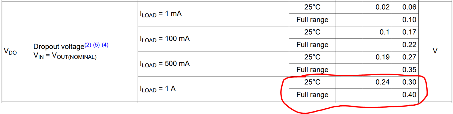

My customer was considering TPS73801-SEP for their design. Their requirements are as follows.
Vout = 0.7V to 3.3V
Iout = <1A
Vin – Vout = <0.5V
Ta = -45oC to +85oC
Looking at Figure 6.4 of the TPS73801-SEP datasheet, they are concerned if they could really use TPS73801-SEP at Vin – Vout < 0.5V without triggering the current limit.
So they also started considering TPS7H1111-SEP instead. However, the TPS7H1111-SEP datasheet does not have plots like the Figure 6.4 of the TPS73801-SEP datasheet. Does TI have plots for Current Limit vs Input/Output Differential Voltage depending on temperature for TPS7H1111-SEP?

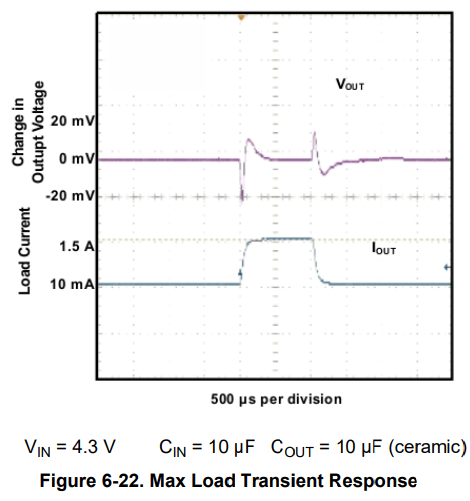

    In Figure 6-14, there is a test condition at the bottom of the image that states deltaVOUT = 100mV. Basically, in this test VOUT is forced to 100mV below it's programmed value to simulate heavy load across the Input/Output range of the device.
    Their load is within the rated maximum load for this part (1.5A), so they will not need to worry about current limit during normal operation. This part does not have soft start though, so they may experience current limiting briefly during startup due to inrush current.
    Since they plan to have a low Vin-Vout differential, they should also be mindful to leave enough headroom to stay above the dropout voltage.
    The current limit for the TPS7H1111-SEP works differently. It does not vary much based on VIN/VOUT differential and the range of possible VIN/VOUT is smaller. The temperature variation is shown in the electrical characteristics table. The test conditions show that the min/max in each temperature row includes variation from operating across a wide range of VIN.

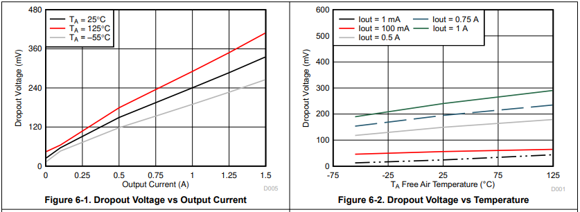

    Regarding your question on dropout at 1mA, typically the dropout voltage is much lower than 100mV but the device does need to maintain some VIN-VOUT differential to ensure it is properly biased to regulate VOUT. 100mV is given as a maximum across temperature and part-to-part variation.
    The TPS7H1111-SEP does have a slightly lower maximum dropout voltage if a separate voltage supply is available to set VBIAS≥VOUT+1.6V (VDO=280mV max @1A). This would give the customer more flexibility with their VIN supply requirements (VIN≥VOUT+VDO). This part also has soft start and a simpler current limit that is easier to understand and guarantee.
    Both parts should work for this design, but the TPS7H1111-SEP would probably be easier to design with and understand.

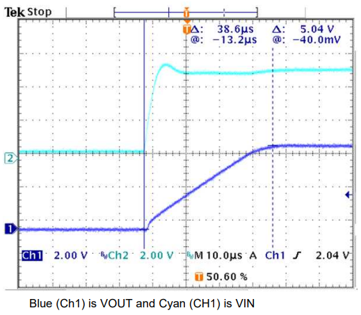

  • Hi Hirano-san,
    Here are 4 scopes showing examples of different startup scenarios. Load current was measured on the input side so that inrush could be seen.
    VIN=3.7V, VOUT=3.3V, CIN=1uF, COUT=300uF
    VIN is pink, VOUT is green, Load is blue, and EN is yellow.
    Scenario 1) EN tied to VIN, No Load
    Scenario 2) EN tied to VIN, 1A load (3.3Ohms)
    Scenario 3) Separate 2V EN signal, No Load
    Scenario 4) Separate 2V EN signal, 1A load (3.3Ohms)
    The maximum value of the current limit in my measurements is somewhat higher than the 25C value in Figure 6-14. This could be due to differences in how the tests were performed, part-to-part differences, or differences in the power being dissipated in the part. Overall, the general behavior shown in my measurements is what we would expect though.
    I hope these scopes clarify the behavior of the part, but please let me know if there are other questions I can help with.
