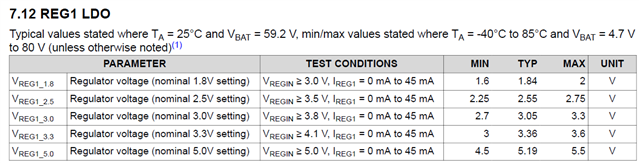

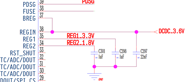

2.  If REG1, REG2 is only configured as 3.3V and 1.8V, the external input 3.6V is OK or not to drive these two LDOs?

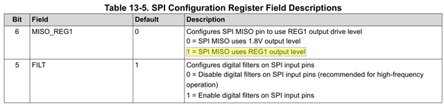

REG1 and REG2 wont' be taken too much current, maybe just for level shifting or SPI_MISO output level supply.
There is no voltage drop infos about these LDOs in datasheets.

    2) If the external input is only 3.6V at REGIN to drive REG1 and REG2, you will not get the voltages you desire at REG1 and REG2. Section 7.12 REG1 LDO and Section 7.13 REG2 LDO on the datasheet (BQ76952 Datasheet), can help provide the parameters needed for you to regulate to the desired voltage.

    2) Section 7.12 REG1 LDO and Section 7.13 REG2 LDO
    Seems the output range is apparently large,  although it's based on full temperature range. It still can not tell the minimum VREGIN for 3.3V output with IREG close to zero.  Anyway I will try to test on board. In fact, in my case, REG1 3.3V is only to supply SPI_MISO output stage.

    2) Additionally, the LDO range is also across the full temperature range AND all load conditions (0~45mA).
