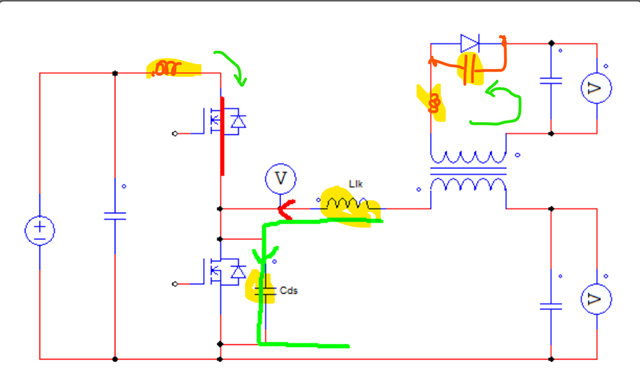

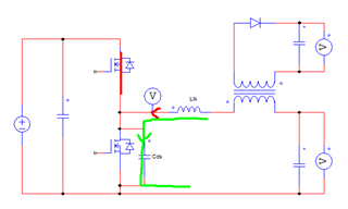

LM5160DNTFBKEVM评估版中,为啥原副边绕组电流以及二极管VD对地,这三个值会振荡呢

Think of a flyback converter for that switching edge, and when the primary side FET turns on, the diode becomes reverse biased and there would be resonance between the leakage inductor resonance with the diode's junction capacitance during reverse recovery.
Hope this clarifies.
Youhao
