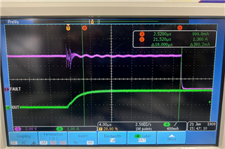

Hi Alan,
Our customer has provided feedback that they are measuring a 2ms response time for the Short Time (ST) function by overcurrent.
Could you perform an actual test on the Evaluation Module (EVM) to measure the trigger overcurrent to ST response time, or contact the design team to provide a definitive time?
Xiaoxiang
I measured a 19us response time in lab.

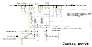

Hi Alan,
Thanks for your help. Here is the SCH.
Could you help to review it.
Xiaoxiang
How is the device being loaded to measure response time? In addition, It is recommended to use the TPS1HC100 device rather than the TPS1H100 it is a newer more cost-effective component.

And Could there be an issue with their schematic?

The device was tested on an EVM. 18V on the input, current limit set to 1A, resistive load set to trigger current limit and flag ST pin. The device we tested detects an open load when the device is both off (if the FET VDS < about 2.5V) and on (if the load current is <8mA). So, a 1k load was placed in parallel to start the test. After the device is running the 18 Ohm load is connected to trigger CL and pull ST low.
Measured IOUT high to ST low.
There is no issue seen in schematic.
