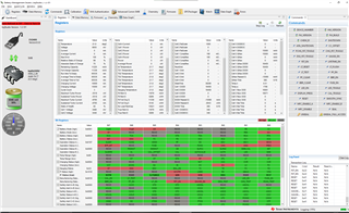

BQ40Z50-R2: Learning Cycle step 4.2.4: No valid OCV reading after hours of relaxing in FC state
Part Number: BQ40Z50-R2
i am attempting to perform a learning cycle as in slua848. However, i am stuck at the relaxing step after charging the battery to full. The REST bit is not being set, even after (so far) 12 hour of relaxing.
I am glad about any help possible, as i am at this point for a few weeks now. Each attempt of the learning cycle takes a >20 h.
i will attach the .gg file, the log of the current learning cycle and a few pictures.
I am using two LiFePO cells in series with 15000 mAh each.
kind regards
Constantin
 goldenimage.gg.csv 1588.registers_log.log

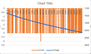

  • Hello Contantin,
    Here is the Voltage and Current vs Time from your log file.
    I am assuming this is during rest. Notice that the current is fluctuating between -3mA and 0A. This is causing the battery to constantly discharge over the 12 hour period. There must be some load or noise with the charger/source that must be causing this issue. The gauge needs to be in a state of absolute state (no discharge or charge current) until it sets the REST bit.
    Siddharth
  • Hello Siddarth,
    thank you very much for the reply and the analysis. I appreciate it very much.
    However, it appears that over the Weekend the relaxing has been successfull. You can see the complete learning cycle below:
    Notice that LStatus changes to 5 after around three days of relaxing. After that i could complete the rest of the learning cycle, as expected. So the issue is technically closed.
    Still, i can say that the only load on the battery during the relaxing phase in the fully charged state was the fuel gauge alone. I disconnected the charger during that phase. The 3 mA noise never disappears. Picture below:
    Therefore the 3 mA noise should not be the reason for the three days of relaxing in FC state. My guess is that i disconnected the charger at the evening of Aug 1st, when i realized that it is fully charged, and then the noise somehow changed into the positive.
    Maybe the fuel gauge is simply not correctly calibrated.
    In conclusion the reason for the long resting phase in FC state remains undisclosed and it confused me, why relaxing is correctly recognized in the FD state, but not ins the FC state.
    Anyway, i simply hope that i do not have to perform a learnign cycle again ;-)
  • Hello Contantin,
    I'm glad that worked. LFP cells require long resting times compared to other battery chemistries, but it still does not explain the 72 hour period. My guess is that the battery needed well over 12 hours to enter a state of absolute rest.
    You may be right about the 3mA discharge pulse. It is well below the discharge threshold, so the gauge wouldn't detect a discharge state. A calibration error of 3mA is not significant.
    As long as you have Ra and Qmax updates, and your update status set to 06 or 0E, you wouldn't have to perform another learning cycle.
    Siddharth
