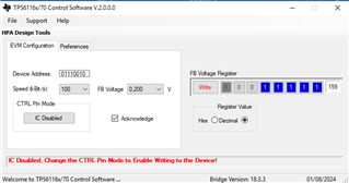

I managed to find a version that I can install, TPS6116x/70 Controller Softwarebut I'm uncertain if it's correct as I'm still experiencing error messages and cannot accurately set the feedback voltage.
The software indicates the IC is disabled, even though it's powered and consuming current, and in order to start writing on the device the "CTRL" Pin mode should be set high (I'm not using PWM Dimming via CTRL pin) (see results in image1).
=> I have powered it up using 5V @ 1A as limit current of the power supply.
  • Image 1:
I've tried manipulating the CTRL pin as per the schematic but without success - It said that the CTRL signal needs to be high, so I shunted it with the the "on" pin side, to be set with the power voltage 5V (indicated with the red circle in the schematic and in the assembly sch. -  see image 2)
In both casses, when the "CTRL" pin in High or Low, the SW tool could not configurate the VFB.

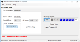

  • As a brief overview, I’m currently using a TPS61165EVM-283 (HPA283 REV. C -2009) with USB-TO-GPIO2 adapter 2006. Despite various attempts to modify the CTRL pin state, the acknowledgment state is not being reached.
    These are the conditions that I applied :
    Scenario ① : Followed the exact same instructions that you recommended :
    1. Removed the jumper of JP1
    2. Connected the EVM to the PC via the USB-TO-GPIO adapter
    3. Supplied the EVM input voltage with 5V
    4. Opened the GUI, switched the "CTRL Pin Mode" to Easy Scale mode
    5. Chose 200mV as FB voltage than clicked on “Write” Button.
    => Still the acknowledgement from IC (driver) did not occur neither did the on-board LEDs light up.

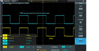

    Scenario : Analog dimming via PWM signal
    4. Connected a Function Generator to the CTRL side of the JP1
    Please note that the Function Generator generates a PWM signal with these specifications : Amplitude ≈ 4V and frequency (PWM) ≈ 7.5 KHz [see picture below]
    => This was the results from the GUI plus no LEDs dimming had occurred even after providing the CTRL pin PWM signal.
    I can’t really identify the root cause of this behavior. I’ll wait for your prompt response.

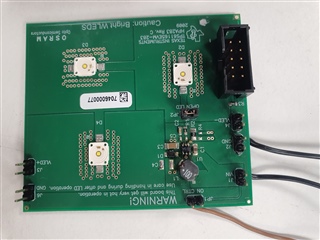

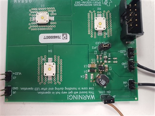

    Could you please take a photo of the EVM with your jumpers' setup? Let me check if there is anything wrong.
    BR
    Patrick
  • Hello Patrick,
    Is it normal for the FB voltage to be around 1.9V?
    1st Test:
    I removed JP1 and tried to control the IC with an external PWM signal, but nothing happened.
    2nd Test:
    I mounted the JP1 jumper, but it still didn’t work.
    Note: I’ve changed the IC several times, but the problem persists. I’ve measured all the surrounding components, and they all seem to be working fine.

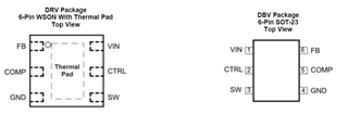

    Seems you soldered the SOT-23 package? The EVM should be soldered with WSON package, and they are not pin to pin capable.
    BR
    Patrick
  • Hello Patrick,
    The component is soldered backwards, so the pinout of the WSON and the SOT should be compatible (without contacting the thermal pad underneath). Both have the same features as far as I know, so this shouldn’t be an issue. As shown in the image, if we mirror the IC, it should be pin-to-pin compatible.
  • Hi Ayoub,
    If you solder the IC backwards, will it light up the LEDs? And you can try to control it with the GUI again.
    BR
