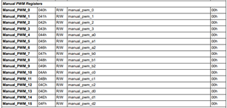

    Q1. Does PWM dimming registers have any default value?
    Q2. Just after LP5810 powered on, PWM dimming data is reset to zero?

    1. Yes, you can find it in the detail register map and here is the link. The default value of PWM is 0x00 for PWM dimming register.
    2. Yes, after powered on every time, the PWM dimming data will be reset to default value.
