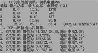

Could you please provide the recommended parameters for this transformer that matches TPS23753? When the customer was testing the temperature rise of the IP phone, he found that the temperature was very high and the transformer was heating up seriously. The conversion efficiency of the entire POE module was only about 60%. So he would like you to provide the recommended parameters to see if there is a problem with the transformer selection, or if you have any suggestions to improve the power conversion efficiency, thank you very much.
The following is the schematic diagram and the matching transformer.

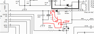

  • Hi Arabella,
    Thanks for your reply. As we discussed in message, please help to provide a layout (.brd file), so we can check if the high power parts are too closed to each others.
    There are two other things want to comment:
    1. The 18.3V Vc is beyond the 18V operation voltage. You can put a linear step down converter to lower its voltage to ~12V.
    2. When you mention the efficiency is only 60%, what is the efficiency curve vs Pout? And did you disconnected 2D15?
