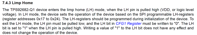

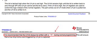

what does this sentence mean in the TPS92682 manual? If 1 is written, does it mean that LH mode will be entered?
It is recommended that the LH bit always be written with a ‘ 1’ during normal programming. This will ensure
that a true limp-home event triggered by LH pin is captured.
    All this means is that during normal writes when you write to Register 01 you should always write this bit to a 1.  Note that writing a 1 to this register does not have any effect and does not change the operation of the device.
