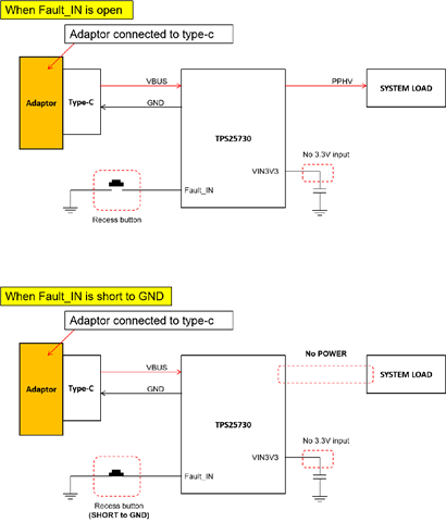

  • Hi Christopher
    I'm using TPS25730,
    and product has a return type/recess type power button, which is for triggering power on by sending a low or high pulse.
    So we're checking if there is method to directly trigger TPS25730 to VBUS on/off by sending a low or high pulse with this return type/recess type power button.
    Duke

  • Hi Chris,
    Let me depict my understanding as following, according to your explanation.
    Please check whether I'm right or not, thanks.
    1. When adaptor connected, NO 3.3V input, and Fault_IN pin is open, VBUS will lead to PPHV output
    2. When adaptor connected, NO 3.3V input, and Fault_IN pin is short to GND, PPHV will stop output
  • Hi Duke,
    Unfortunately, I do not think the TPS25730 has the feature you want.
    Correct
    Partially correct. What really happens is the PD controller will Hi-Z the CC pins, which manage the PD and type-C power negotiation. This will immediately cause the far end source to disconnect power, and the TPS25730 will lose power (b/c not powered through 3.3V input). Then the TPS25730 will reset due to lost power, and the system will attempt to start a new contract, and repeat the previous behavior.
    Without the VIN3V3 power, there is no stable way to disable the port.
    Thanks and Regards,
    Chris
