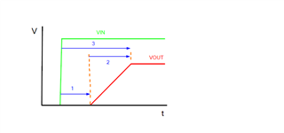

Sounds good, I'll order the parts and measure it when they arrive. In the meantime, can you tell me how you would like me to specify the delay? Does 1, 2, or 3 from the diagram below describe the delay you would like measured?
This device was released in 2000 when the timing characteristics of LDOs (and really a lot of other specs) were not well-specified (in my understanding - I was not an engineer in 2000). Most of our modern devices have timing information, at least in the form of a transient waveform showing the startup or sometimes an actual EC spec.

Yes, if you can do all 3 measurements, it will be perfect. At what load are you going to test (0A, 50%, 100%)?

Sounds good. Is there a load to start up into that would be of interest to you? If not I would normally use some "small" load, say 10% of the rated load current (100mA for this device), but if you expect to start up into a heavier load then I can use that. The startup is usually not affected too much when the load cap is not very large or the load current is not large, but can be affected if either is large, in particular the case where the device gets to current limit during startup. Also, the electrical specifications were characterized with a 22uF output cap (probably solid tantalum); do you know what you would use if you went with this device? Ceramic caps can't work on their own for this device since there's a minimum ESR requirement of 100mΩ.

Here are the startup plots with cursors to measure the requested timing information.
