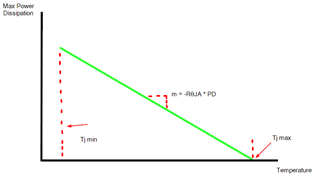

Sorry what I want to know is the maximum PD.
I would also like to know the relationship between PD and temperature.
Ryu.
Hi Ryu,
Yes, my reply is referring to the more complicated issue of thermals, and I can't tell you the maximum power dissipation because there are many variables that affect how much power dissipation the device can handle (in particular, board layout, device package, and ambient temperature are the major influencers). In general it will look something like the diagram below for devices like the LM317M that have a high potential power dissipation (with VIN - VOUT max being 37V and 0.5A rated load current), but the slope is largely affected by the board layout and package thermal metrics. Do you know the max ambient temperature, max load current, and which package you are interested in for your application?
