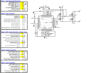

Can LM5177 operate in a large range of output voltages? If so, how should the system elements be selected:
  • Inductor
  • Resistor
  • Compensation network
The Excel provided by Ti does not have the ability to set the output voltage range, only one specific value, and the webench changes the values ​​of the coil, current measuring resistor and compensation system with each change of the output voltage.
The designed system should have an input voltage of 24V and an output from 0 to 60V, with a maximum power of 60W. The maximum current is 5A.
I tried a few combinationa, but I always had problems with stability.
