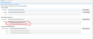

I m trying to send 20 byte zero challenge to bq40z50r2 device to collect digest value via block read/write operation by using Stm32L412 microcontroller for authentication purposes.My 16 byte key value is AAAAAAAAAAAAAAAAAAAAAAAAAAAAAAAA.Digest value must be 116c9b5d1dcea88170eee9d5f9ad4e85026a9f8c
I m getting this value over bq studio by using read/write block operation successfully.(sometimes i can collect zero , maybe because of timeout).When i start to collect data over my microcontroller , I can get correct data sometimes.In other cases I get empty data or noise data.I m using 0x2F command to send 20 byte block zero challenge data and there is 250 ms delay between write and read operation.

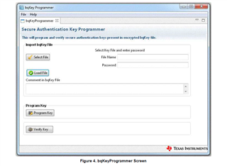

Additionally , there is no bq bms programmer visual interface except command programmer like below:(In TI Fuel Gauge Authentication Key Packager and
Programmer Tools document , there is a key programmer like below)
