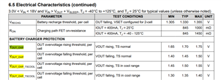

Hi all,
I would like to ask the question about Vout_ovp.
I think the pressure value of NiMH battery is usually 1.5~1.6V,
but the voltage value of this device to detect end of charge is 1.7V(typ), which is higher than usual.
Is there any reason why it is higher than usual?
