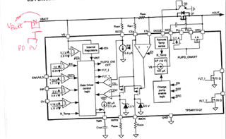

We are designing for a 55V battery system. I think that TPS48111-Q1 is suitable.
However, we need to withstand a reverse battery connection, upto -60VDC.
Can I add the reverse polarity mosfets as follows on the next drawing. We would connect its gate to the gate PU-PD of the other inrush mosfet Q1.
