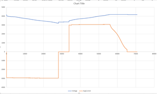

learning cycle was successful,but discharge SOC It jumps from 30% to 0% every time.How to set up to solve this problem.Attached is the saved log.bq27520-G4_EV2300.xls
chemID:5235 ,the actual cell used LISHEN 8P LR1865Sx,capacity of a single cell 3000mAh.0550.gg.csv

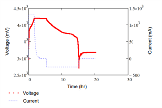

You need to use the GPCCHEM tool to get a ChemID match with DOD% error of 3% or less.

Do you know how to deal with the problem? log7.ziplog7-report.zip
your .zip file should only contain 2 files.
The data you submitted does not begin with a charge phase and end with a discharge phase.
Please match the graph below.
Please follow the steps in this document: Simple Guide to Chemical ID Selection Tool (GPC) (Rev. A)
