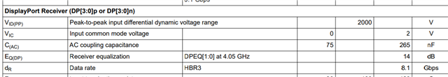

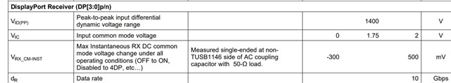

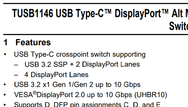

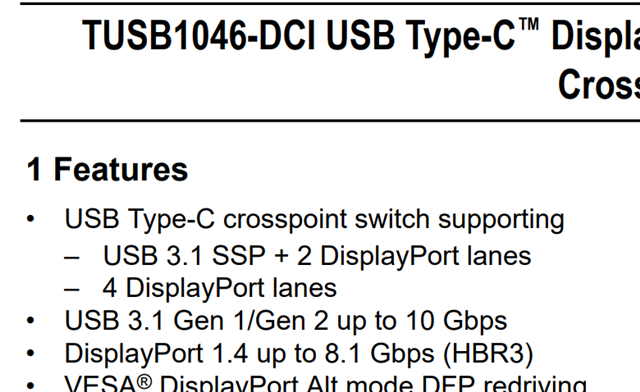

    TUSB1046 supports DP1.4 HBR3 or 8.1Gbps. TUSB1146 supports DP2.1 UHBR10 or 10Gbps. TUSB1046 does not support AEQ while TUSB1146 supports AEQ. Both TUSB1046 and TUSB1146 support USB 3.2 Gen 2x1 or 10Gbps.

    The supported DP compliance is not determined by the AEQ. The supported DP compliance is determined by the re-driver design itself.
    The TUSB1046 can only support up to HBR3 or 8.1Gbps, it will not pass the UHBR10 compliance. UHBR10 is outside of the TUSB1046 design spec.
    The TUSB1046 only supports fixed EQ so EQ has to be tuned in order to pass the DP compliance. The TUSB1146 supports both AEQ and fixed EQ.
