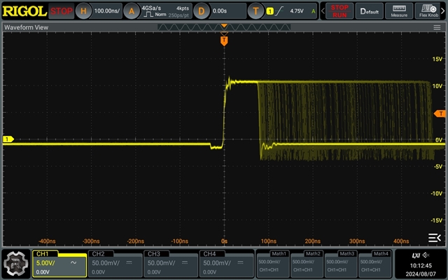

Here is the waveform at the LX1 pin under no load:
and under 2A load:

  • More information:
    I have increased the cap across R16 from 100pf to 10nF. R17 is 20K and C46 is 3.9nF X 2. The output is stable under load now, but as might be expected the transient response is poor. Here is the output voltage when cycling the load between 10ma and 2A:
    Any ideas?
