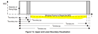

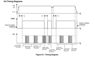

    1) Since the watchdog timeout pin (WDT) is connected to VDD, the timeout is 2.5 s. And when the window watchdog ratio pin (WDR) is connected to VDD, in this configuration the ratio is 1:127.7, the lower boundary is 19.6 ms.
    2) The device must detect a rising edge at the WDI pin between tboundary,max and twindow,min to prevent asserting a reset
    Please check 7.3.2 2 Implemented Window-Watchdog Settings and 7.3.2.1 Timing Rules of Window-Watchdog for more detail information

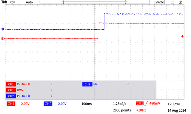

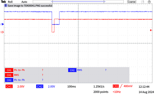

  • Hi Sila ,
    Blue one is TP8 WDI pin .
    Red one is Reset pin .
    this is scope image at power up
    after getting started  every time resetting pulse occur  .
  • Hi Ankush,
    Thanks for the scope pictures. Power up seems okay.
    It seems like the reset is asserting due to late fault. The WDI positive edge seems like comes after the assertion. Can you please send another WDI signal that has 300ms or 400ms  smaller period than this signal so that WDI positive edge will be occur in the window frame?
