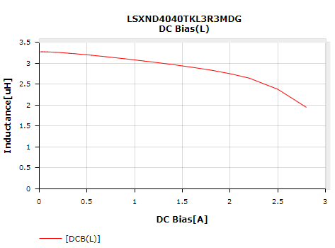

Regarding the inductor, the main parameters are listed below:
Type
Wirewound
Material - Core
Inductance
3.3 µH
Tolerance
±20%
Current Rating (Amps)
Current - Saturation (Isat)
2.3A
Shielding
Shielded
DC Resistance (DCR)
66mOhm Max
Size / Dimension
0.157" L x 0.157" W (4.00mm x 4.00mm)
Height - Seated (Max)
0.071" (1.80mm)

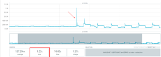

We have done some measurement of the load current profile without the DCDC enabled.
The load current profiles first in normal situation (Iavg = 120mA, Imax = 312mA) and then during the maximum load (Iavg = 380mA, Imax = 550mA) are reported below:
The most critical situation is when the load is connected suddenly by hot plugging. You can see below the load current spike of 1.03A:

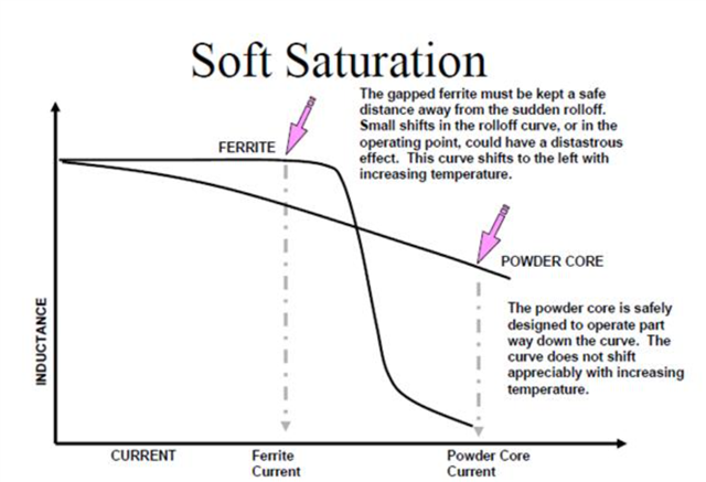

    We recommend selecting inductor with Isat> IHS_LIMIT(3.4A for TPS62932).
    During start up, the converter need to charge the Cout so that Vo rise to the set value in the tss, the iL can be large and may hit the IHS_LIMIT, especially when Cout is large.
    The 2.3A Isat of the inductor is too small, the datasheet didn't specify the effective inductance under >2.8A,  ferrite core can have sharp saturation curves. Please replace L1 with a inductor with Isat>5A, and see if the issue can be solved.
    The load profile has steps and spikes, is this a programed load profile? What's the load of the TPS62932?
    Thanks and best regards.
  • Dear
    thanks for your reply. The load profile has steps and spikes because it consists of: microcontroller, digital sensor with an active heater system, 2x relay, and a pulsed IR lamp with duty cycle of 2Hz that by itself alone requires 115mA in active mode, etc...

    1. Can the use of the LSXND4040TKL3R3MDG inductor in this configuration damage the DC/DC or the load in a short time? It's very important to have an answer to this question because we have to stop the delivering of those products to our costumers in case this risk can exist.

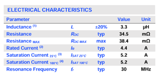

    4. We selected a possible substitute for the inductor. Could this P/N: MPL-AL4020-3R3 be a good replacement?
    I report the main parameters of the inductor MPL-AL4020-3R3:

    4. The inductor is ok.

    Actually we are testing 3 units with the following inductor part number:
    1. P/N: MPL-AL4020-3R3
      • Inductance = 3.3uH
      • Current Rating = 4.4A
      • Saturation Current = 5.2A
      • Rs = 34.5mOHm

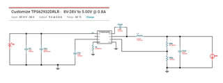

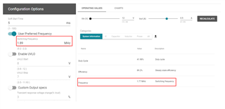

    I'm trying to use your WEBENCH tool to redesign our schematic. I'm experiencing some difficulties in use it:
    1. WEBENCH sometimes automatically sets the "Configuration options" diffrently from my choises, so I can't analyze the system performance and do simulations.
    2. I noticed that, once I set the "Switching frequency", when I recalculate the operating values for different Vin, the Fsw listed is not the same as the one set in "Configuration options". Is it normal?
    Can you help me to use this tool? This point is becoming critical because we are about to produce a new batch of units and need to find a solution to the problem reported in the previous messages.
    I'm trying to costumize the design with this configuration:
    • Vin: 8-28V
    • Vout: 5V at 0.8A
    • Small Footprint Design optimization
    • Soft Start Time: 5ms
    • Output Cap Type: Ceramic
    • Cff disabled (we can't add this capacitor because actually we can't modify the PCB, only do a component replacement)
    Can you kindly let me know if you can support me in this task?

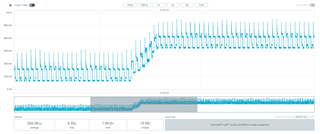

  • Also, can you measure the Vout and SW  during normal load profile and check if it works normally? The Cout is one 0805,22uF,10V ceramic cap, I didn't find the effective capacitance curve under 5V DC bias, but it might have > 50% capacitance derating under the 5V bias. You can try adding more capacitance.
    For the webench simulation, I see in you schematic the RT is connected to GND, the fsw is 1.2MHz.  The Cff can't be disabled in the simulation to gain enough phase margin for the loop stability.
    https://webench.ti.com/power-designer/switching-regulator/customize/91?VinMin=8&VinMax=28&O1V=5&O1I=0.8&base_pn=TPS62932&AppType=None&Flavor=None&op_TA=30&origin=pf_panel&lang_chosen=en-US&optfactor=3&Topology=Buck&flavor=None&VoltageOption=None

    We have done a few test, here below the recap:
    1. Load with 10Ohm resistor at 5V and 7.5Ohm resistor at 5V to simulate 500mA and 650mA steady load, providing multiple fast connect and disconnect of input with several voltage including 24V, 12V, 7.5V and 5V. Nothing happened, the circuit didn't show any problem.
    2. Minimum load close to zero (can be least than 1mA) providing multiple fast connect and disconnect of input with several voltage including 24V, 12V, 7.5V and 5V. Nothing happened, the circuit didn't show any problem.
    3. Load with 10Ohm resistor at 5V to simulate 500mA with power at 7.5V and 24V with a 7.5Ohm resistor in series with the power supply to simulate bad external power supply condition. Nothing happened, the circuit didn't show any problem.
    On monday we will do the measurements required by you with a proper instrument and we will try to inject signals to get the Bode diagram and we will post you back the results.

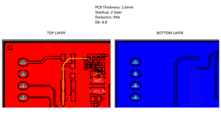

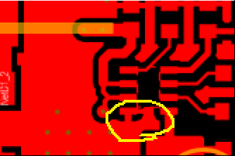

    Regarding the PCB layout you can have a look here:
    The only possible ilimitation should be the one highlighted in yellow:
    1. 20 mil input track with 37mm length and 38 mOhm resistance separating the 2x10uF bulk capacitors from the input pin. The 0.1uF capacitor instead is closed to the pin.
    2. By mistake of gerber revision, there is a separation between the SW pin and the inductor with a 8mil track with 0.2mm length, see the Top layer artworks.

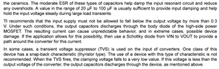

    Also, please, have a look to the input protection circuit. We found a note on datasheet that TVS on the input side with "snap-back characteristics" is not reccomended.

  • Hi Roberto
    The layout has some issue and must be optimized if you got chance.
    • The Cin should be placed as close as possible to the IC Vin and GND pin. The Cin in your layout is not close and the Vin trace is thin, there can be larger parasitic inductance on the Vin trace and this can cause voltage spike across the mosfet during switching, especially when Vin hot-plug. You can test the SW voltage and there should be voltage spike. And you can add a 0.1uF cap close to VIN and GND manually and the spike should be able to see the spike becomes smaller.
    • Please connect the GND in completely, do not leave this hollow.
    • The SW trace is too thin, which will also cause larger parasitic inductance and higher voltage spike.
    • The feedback resistors ,R3 and R2, should be placed close to the IC FB pin. R3 should also be close to the IC GND pin.
    Attach the layout example of the EVM, and there is pcb layout guidance in the 12.1 section in the datasheet.
    Will you be able to optimize the layout before the 21th August production? I think this is quite important.

    For the TVS,  if the TVS broke and clamp the Vin at a low rate voltage, but the Vout is higher than this voltage, there is voltage across the HS and there can be large current flowing through the body diode, that can cause damage. the diode you selected do not have a snap-back characteristic, it should be ok.

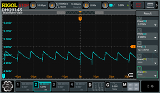

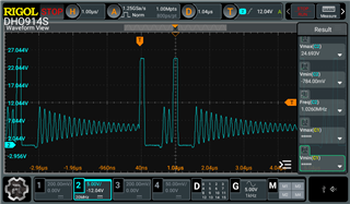

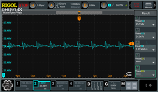

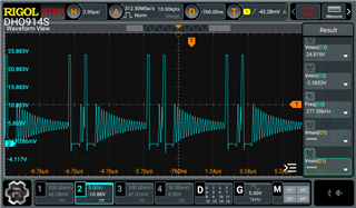

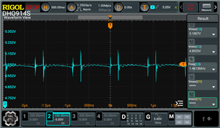

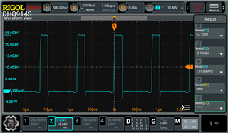

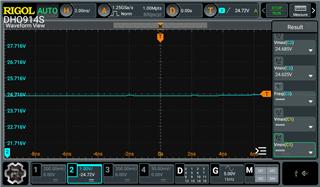

  • Dear ,
    here below a few measurement, with a 125Mz digital oscilloscope:
    1. Vsw without load
      1. Test conditions: Vin = 24V, Iout = 50mA, BW limit = none
    2. Vout without load
    3. Vin without load:
    4. Vsw with 10R load:
      1. Test conditions: Vin = 24V, Iout = 500mA, BW limit = none
    5. Vout with 10R load:
    6. Vin with 10R load:
    7. Vsw without load:
      1. Test conditions: Vin = 24V, Iout = 50mA, BW limit = 20MHz

  • Hi Roberto
    We didn't see SW voltage spike from the waveform, Can you measure the SW during start up? Better to have Vin, vout ,SW on the same page.
    For the damaged devices, are these pcbs with new inductors? Can you measure the damaged device and see check the Vin , SW ,GND pins and see if there are short-circuit between these pins?

    • 1x unit stopped working during the oscilloscope measurements while the probe was connected to the SW pin and the nearest ground. This happened at first start-up
              -------Did you start-up the circuit by hot-swap? Can you catch the waveform?

            2. Review the entire layout design, but this means stopping the next batch of production putting the existing PCB in the garbage. Can this layout improvement resolve the issues at 100%?
             ---------cannot say for sure now without test verification. But the layout does need to be optimized.

  • I noticed in your schematic that you have the EN pin connected to the regulator VIN pin.
    In the TPS62932DRLR datasheet, it states the absolute maximum voltage on the EN pin is 6V.  It seems like applying 24V to this pin is likely to cause internal damage to the IC.
    We are seeing IC failures that appear to be very similar to yours.  We also connected the EN pin to VIN.
  • Thank you J.F. for pointing this! I have missed that.
