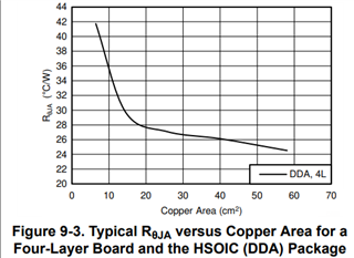

I have a question about the thermal information of LMR16030.
Please tell me the measurement conditions.
For example, a 4-layer board with a size of 100mm x 100mm

Hi Ishiwata-san,
Looks like this EVM didn't undergo the thermal simulation but instead it is based off the LMR16030 and LMR38020DDA test.
