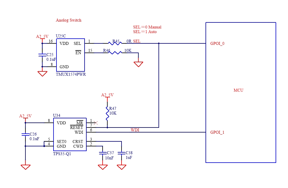

HI,I already have the chip TPS35AA38AGA.
There is an open-drain reset output latch application.
How to design an output Latching circuit using the TPS35AA38AGA?
  • Hi Jianhao,
    There are ways to use discreet circuitry as well as a control GPIO to implement a latch on the output of the TPS35AA38AGADDFRQ1 device. Could you please share your schematic including the TPS35-Q1 device as well as any corresponding devices and connections that share any net with the TPS35-Q1, with this I can help to add the needed circuitry to provide a sample schematic that would include latch.
    Joshua
  • I would like the TPS35 to force the SEL of the analog switch TMUX1574 to 0 and switch to manual when the MCU can't reboot successfully

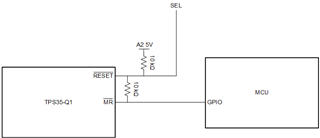

  • Hi Jianhao,
    Thank you for sharing your schematic. In order to latch the reset I would recommend you add a resistor between MR and RESET, that way whenever the RESET goes low MR will be pulled low and the device will be stuck low until a GPIO pulse is provided to MR to clear the latch. For this configuration during TPS35-Q1 startup you will need to provide a GPIO high pulse to the MR so that the device does not latch on startup.
    During TPS35-Q1 startup the RESET will go low, with this latch configuration you will need to provide a GPIO high pulse to the MR so that the device does not latch low on startup.
    Joshua
  • I have tried it and it works.
