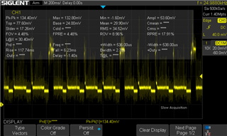

In this scope capture is the voltage across the 100 ohm Vcc resistor, so the average current is "Mean=29.90mV" or 299uA (it should be less than half of that in sleep mode.)

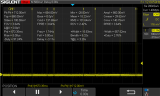

Here is the thermistor pin (TS1) It should be 1 pulse every 5 seconds with the settings I'm using, ~1.5 sec. is the longest low time:

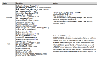

    Thank you for sending that over. Based on the TS1 scope capture from above, I believe the device is still acting in normal mode since the pulsing is occurring in 1.5s periods.
    I see in the .gg file the sleep current threshold is currently set to 10mA. Can you please confirm that the current being seen across the sense resistor meets this threshold, along with the other conditions detailed below are being met?
    Anthony Baldino

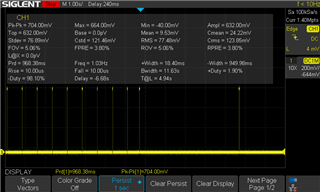

  • The TS1 sample rate is steady 1 per second, 300+ uA draw, then in sleep it's supposed to drop to 100uA draw and only 1 sample per 5 seconds.
    I have only seen 1 second and then the random shown above on our board.  The EVB always drops to 1 sample every 5 sec when it sleeps like this:
    I have never been able to get our board to show the 5 seconds delay between samples.
    Also I have used "In system sleep" combined with "bus timeout=0" to make it sleep even with the EV2400 connected, and I can see the sleep status bit stays on, but the 1.5 second random-ish pattern continues.
